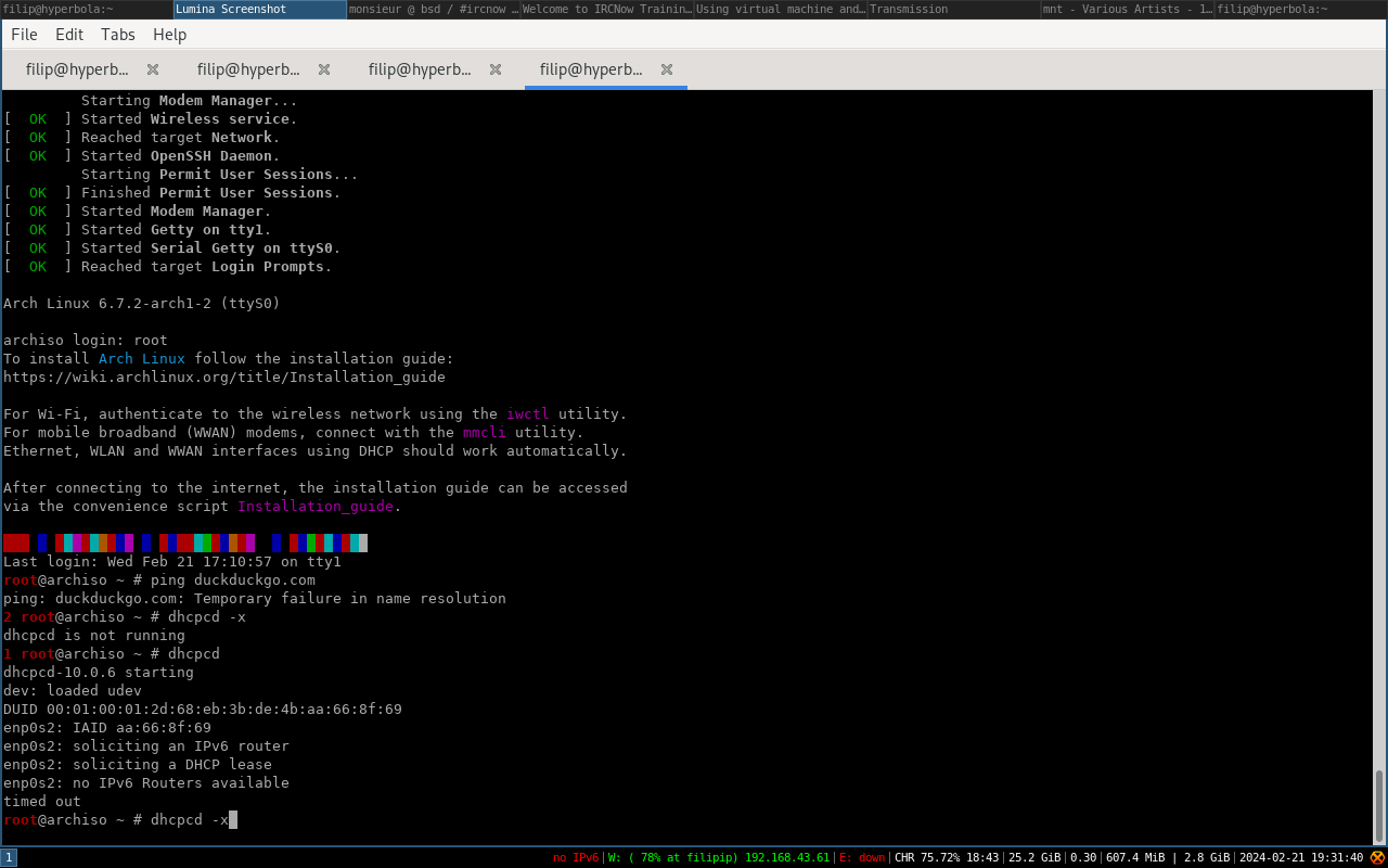

    Append console=ttyS0,115200
    [Image: Screenshot-2024-02-21-19-31-42.png]

    I am now stuck with installing joborun on the VPS
    Arch Linux won't detect android (crap)phone to get usb tethering internet connection, there's now wireless interface too
    Other arch linux based distros won't even boot
    Gotta try devuan .iso and download arch-linux scripts seperately.
